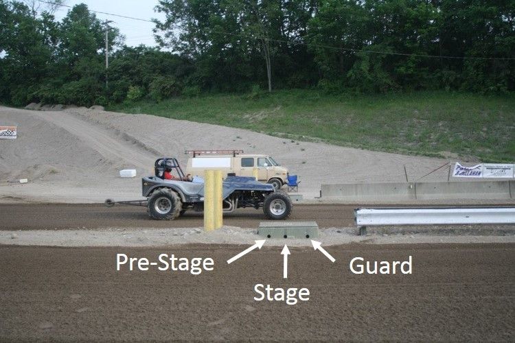

Thanks to Damian Bowers for taking these photos, that show the setup perfectly.
Most everybody understands the pre-stage and stage beam's primary function. They are there to show you when you are staged up properly at the beginning of the race. Obviously they trigger the lights at the top of the tree when your tire (or some vehicle part) breaks through that beam.

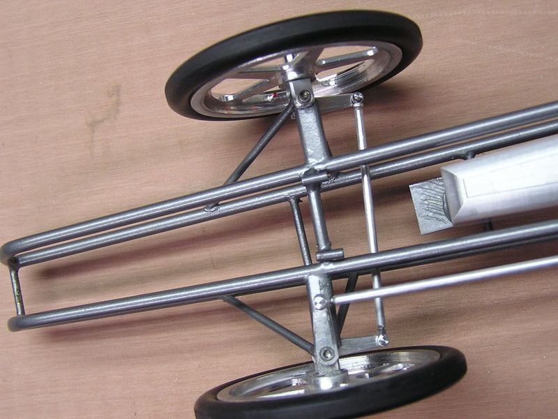

That seems simple enough. So why would you need a guard beam? At some point drag racers got smart and figured a way to bend the rules a bit. They started to offset the front tires to maximize the amount of time their tires stayed in the stage beam. Thus increasing their rollout. By the time the beam had re-connected the car was quite a few inches further down track. It lowered their ETs and allowed them to leave earlier on the tree to get a starting line advantage over their competitor without a redlight. This photo of an old front engine dragster model, shows what I mean.

2) Guard Beam Starting.
This system activates the timing system once the guard beam is broken. Again, if that beam is broken before the light is green, a redlight occurs. Therefore you have about ~16 - 18" of vehicle movement before you redlight. It also gives you a little time to get some speed going before tripping that beam. It helps reduce ET. Obviously the greater the distance between the stage beam and the guard beam, the lower the ET potential is. That's why shallow staging can help lower ETs when trying to reduce that ET for a qualifying spot.
That works fairly well with most sand drag tracks. But there are two issues. First, if you have a lot of overhang on the front of your vehicle (fenders, spring shackles etc) you can have guard beam issues. Especially if the track hasn't been groomed in a while. You may roll in and trigger both the pre-stage beam and stage beam with your tires, but due to the holes, you're sitting at an angle large enough to have the front of your vehicle breaking the guard beam. You'll never know it, until the tree activates and the red light comes on instantly. That's due to the guard beam being broken.

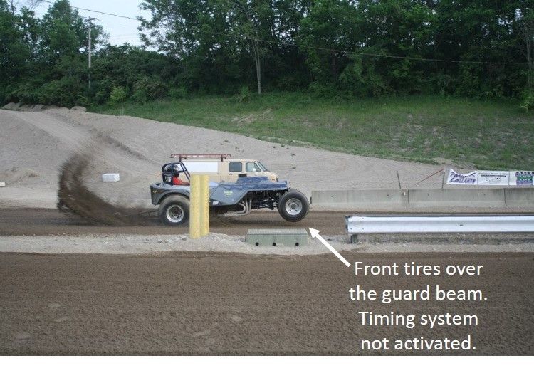

The second issue is the one occurring more frequently the past few years. That's known as "jumping the beams". It happened a little bit in the past. It wasn't widely known. People would get a strange time ticket and not understand why.
In these pics, you can see that the vehicle has launched. The front wheels are clearly over the stage beam. The guard beam is still connected and has not been broken. Therefore the timing system has not activated. The vehicle now has the entire wheelbase of the car to accumulate speed before breaking that beam with the rear tires and activating the timing system.
In these cases an ET will be much quicker than a normal run for that vehicle. In the case of our car, it's been on the order of about 0.4 - 0.5 sec. Your reaction time will also be very slow, and your 60' time extremely quick. Unless, you carry your front wheels over the 60' beam as well. On nitrous we've seen ETs as quick as 2.7's with our car. That happened in the first round of Gravelrama for us last year. It does look cool to the fans when it pops up on the scoreboard, but it's frustrating when you'd like to know your real time. It's one of the reason you'll see some sort of rag or strap hanging from the front of a lot of the cars that tend to wheelie. The rag is there to break that guard beam.
The moral of the story with guard beam starting on a sand track is have the beams high enough that it's difficult to jump, while not so high that it interferes with the full body vehicles.

Moral of the story from these pics.
I hope IOK can check to see if they can raise the beams to the proper height within the next month.
