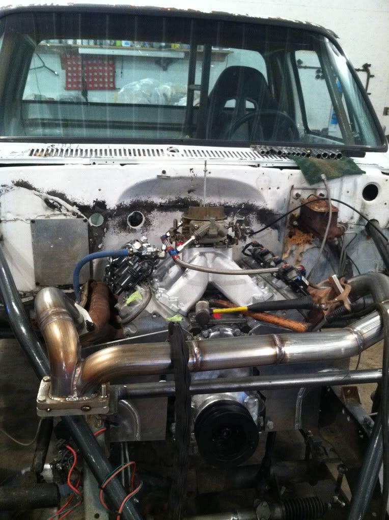

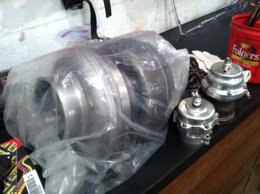

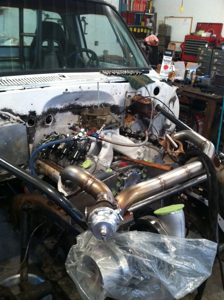

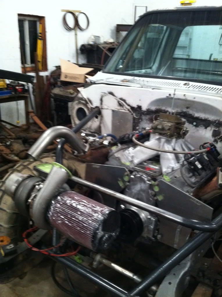

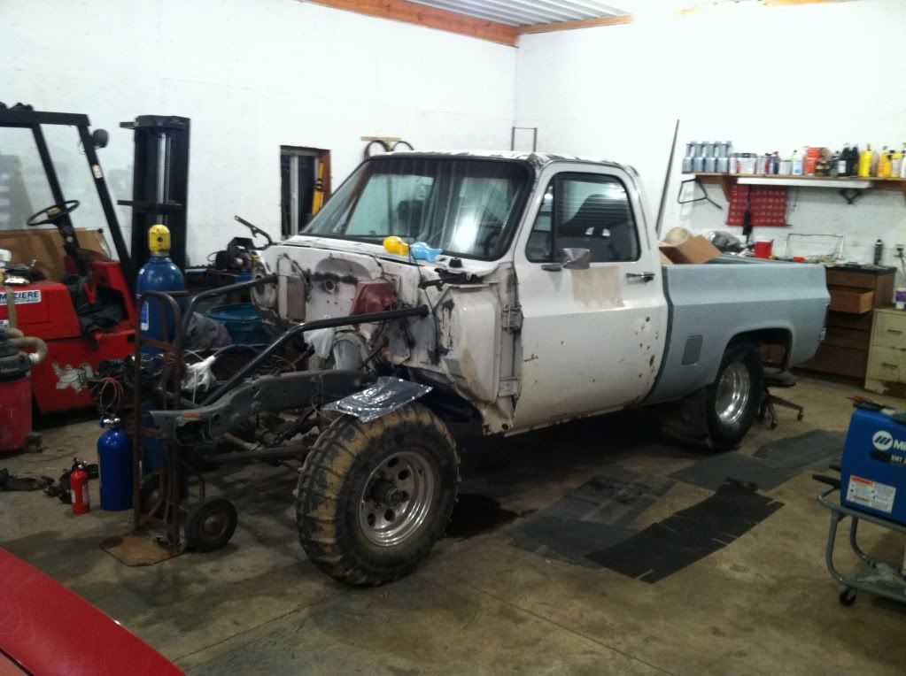

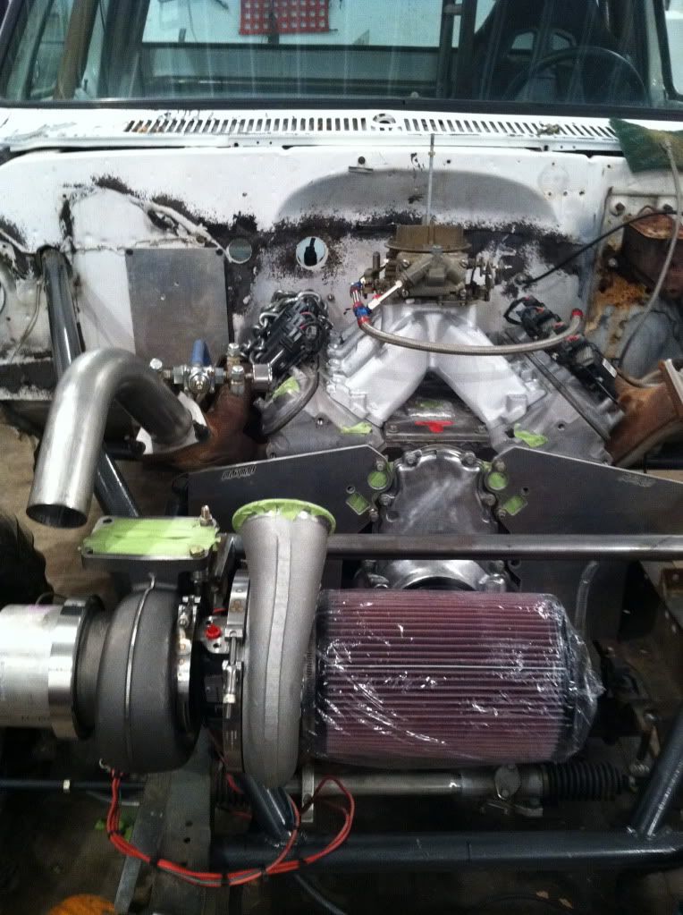

Postby tpatton » Thu Dec 29, 2011 4:44 pm
Ive had some time to get a little work done but its still a ways off.All the hotside is done and functional,coldside is to but for now it has a carburetor for start up and leak check.Its a miracle but everything is airtight and I was able to start it for a short time today.Sounds very mild and quiet.Now I just have to get the rest of the injection on and mount the fuel pump.ImageImageImageImageImageImageImageImage[url=http://s1223.photobucket.com/albums/dd504/fmillop/?action=view&current=IMG_0199.
