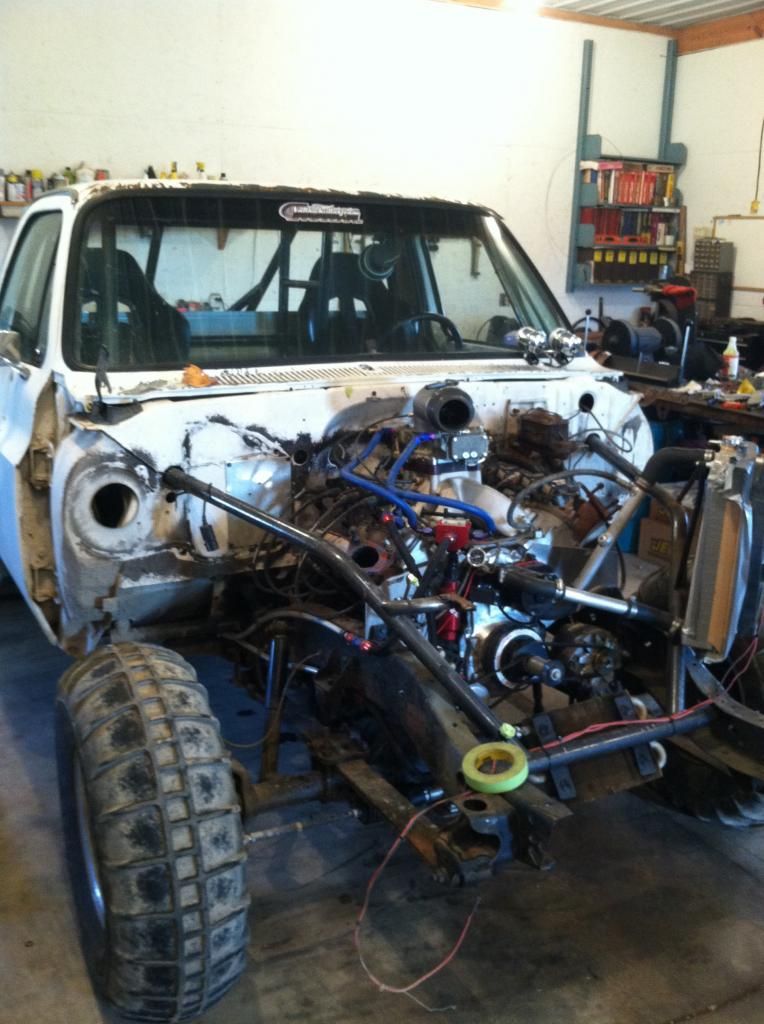

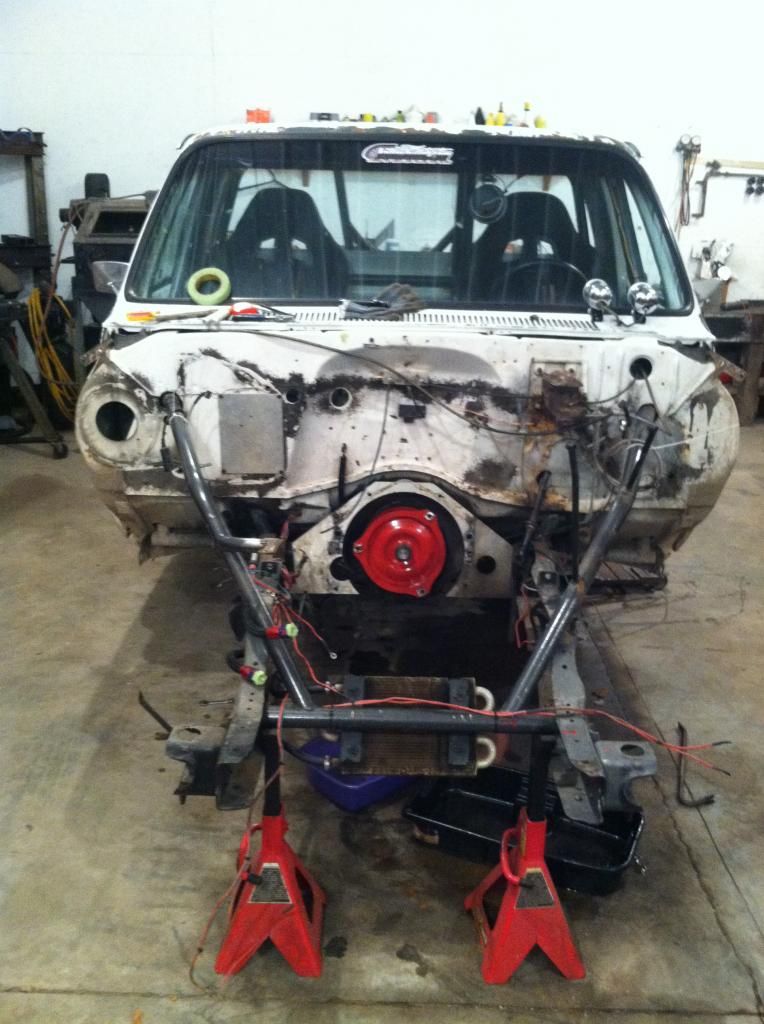

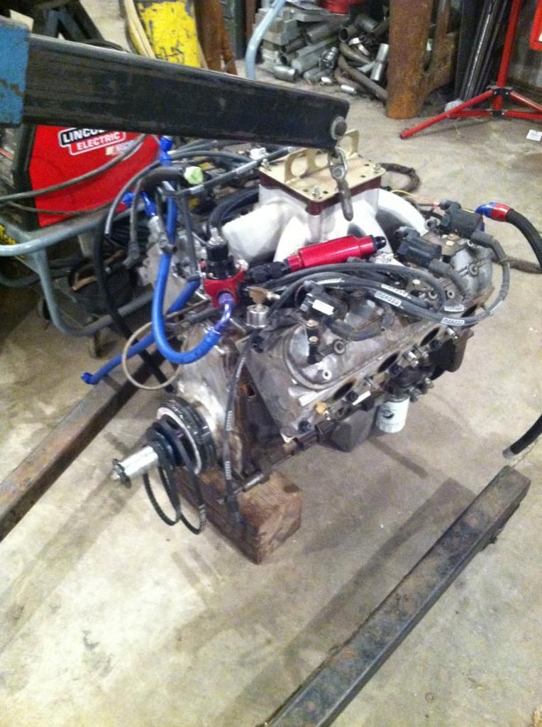

Postby tpatton » Tue Oct 30, 2012 8:12 pm
put a little work in today and cut the frame off.Carrol sent me the info needed on where to cut and what to level off of.Its good to have all the friends I have to get information from.I think this puts me past the point of no return.Now I just need to get the tranny out of there and start cutting the firewallImageImageImage

Postby nick-m » Wed Oct 31, 2012 1:00 am
cutting the firewall? gonna move eng. back too?
nick-m
Posts: 39
Joined: Fri Dec 02, 2011 10:48 pm
Re: another chevy shortbox gets a transplant
Postby tpatton » Wed Oct 31, 2012 2:36 am
Planning on 10 inches right now, maybe more depending on legroom. I have to be comfortable. I'll know more this weekend. Nick are you guys coming back out next season?
