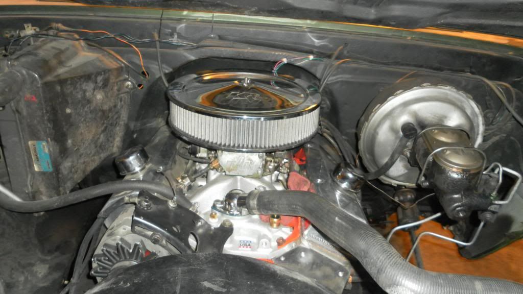

THE BOSS wrote:My pink intake! first cleaning, several more to come, it will look better than new.
the rest of the parts on are on the way for the engine!! whoooohoooo
i had to get rid of this, leaked vacuum like a mo-fo at the carb with a Demon. i didn't realize when i bought the intake it was for a spread bore. a new made in the USA intake for a holly from the good fellas at Cascade 4WD fixed it up!

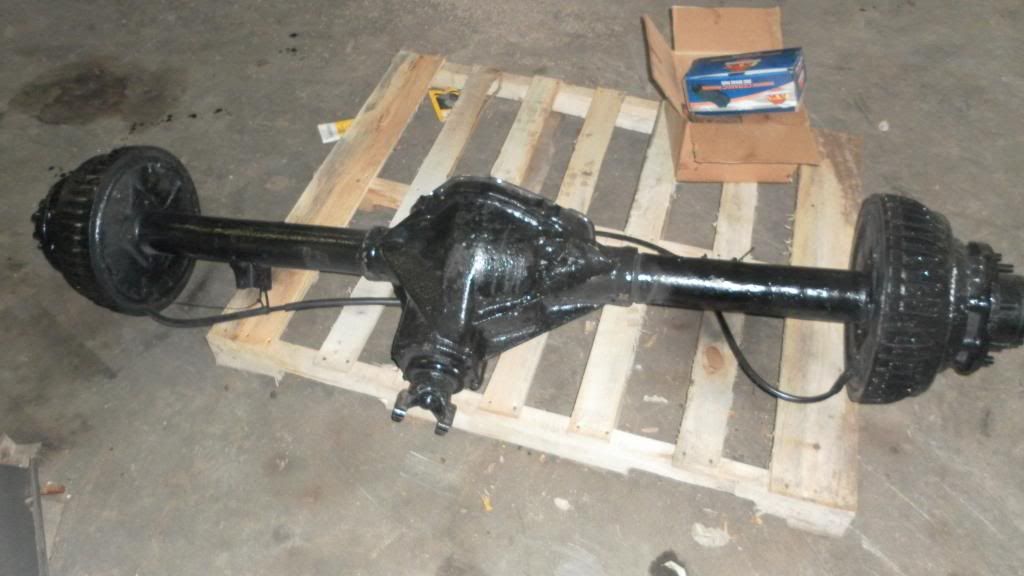

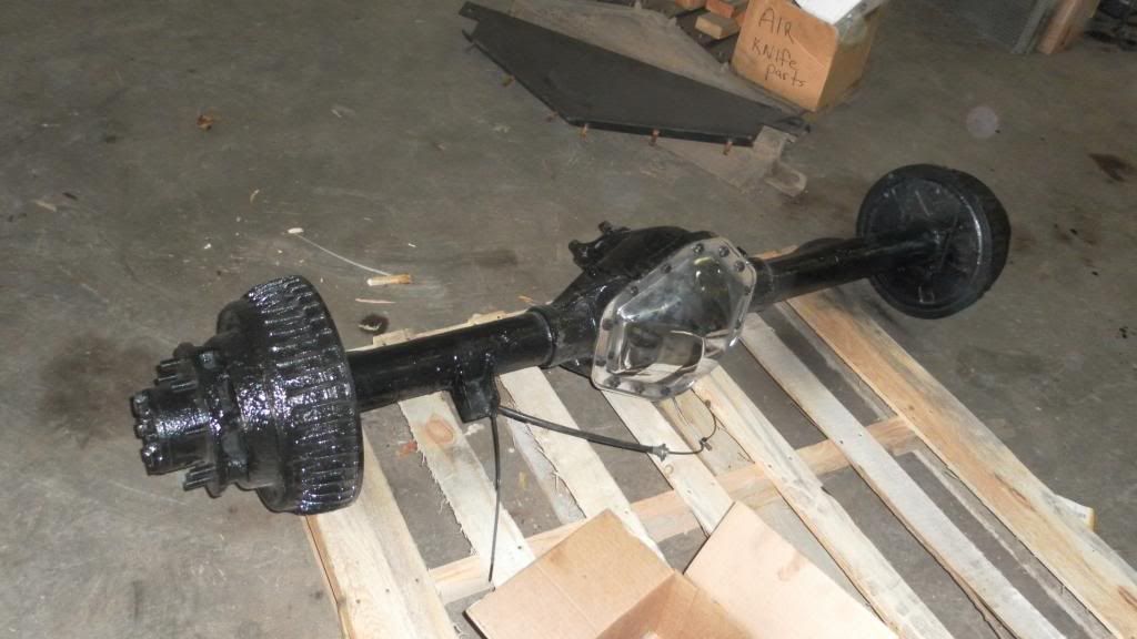

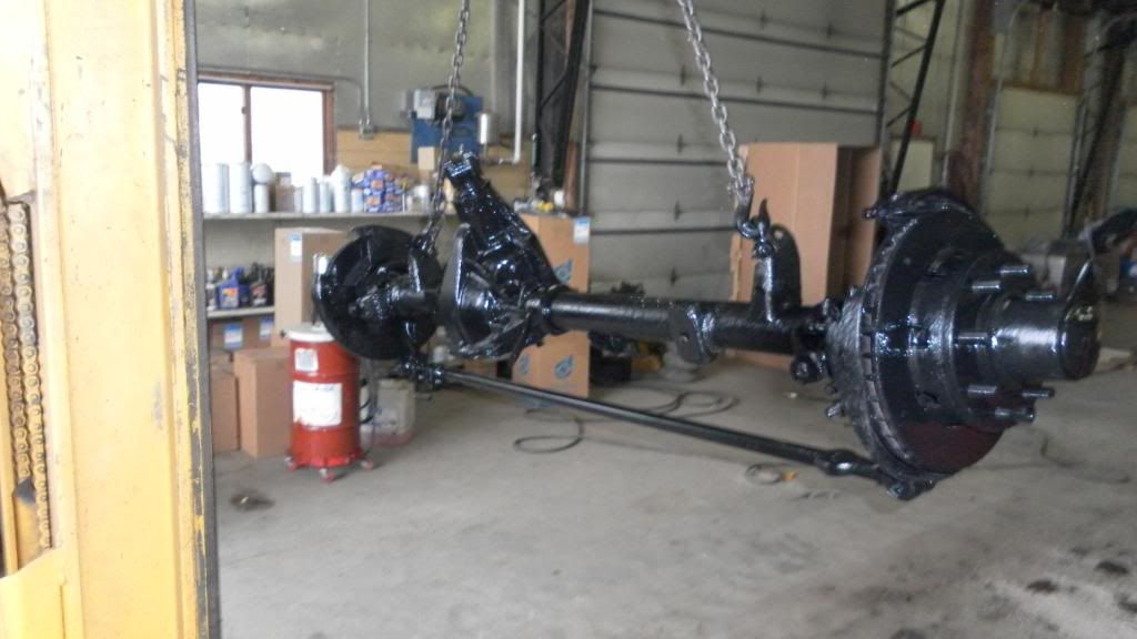

I saved these axles life's from rotting away. found them near me for $300, put around $450 in them, real nice now, gears all looked real good. GM 14 bolt rear and GM 10 up front

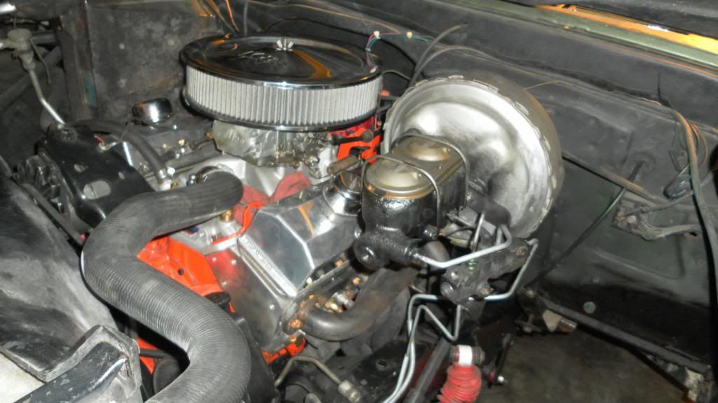

some recent of the engine with the new valve covers. i had to modify the valve covers, the corners hit the firewall.
