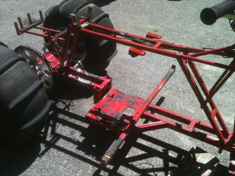

Postby chainreaction » Fri Aug 16, 2013 8:43 am
Time for another update.
The chassis has been stretched to 90", again: stronger-lighter.
Motor mounts in, motor in, chassis stripped and painted.
Pipes hung, working on pipe supports. (now done, we dropped the front of the pipes more to get the tips aimed up and over the tires.)
First test fire, started first pull! Thought he was going to wet himself. He had goose bumps for an hour!
