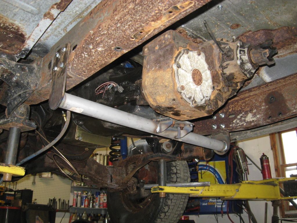

So we got the 460 in the Bronco without much issue. Some L & L mounts and Mad Dog headers made it pretty easy. Had the 2wd trans converted over to 4x4 and attached a NP 205 case and custom cross member. Next was the chopping off the front frame rails and mounting the radiator. After a new electrical system was made and some custom driveshaft's installed we had a running , moving truck.Image
